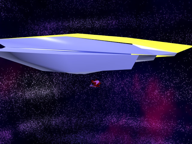

Pixel resolution is only for printing on paper, so you are wasting a whole load of computer memory for nothing. I have made starfields using a texture on the inside of a sphere. 2048 *1024.

I tried the sphere method first and despite the stretching I had a problem with the texture towards the top of the dome, using the UV function only created problems elsewhere laterally.

Well my Sphere is huge so the bending is gone, but the stretching is visible. However, this sphere is so large that you can fly for 1000's of miles inside it, so if I scaled it down so that you could not fly so far it would look much better.

It's a game, and size doesn't alter the running speed of the game. I don't think it alters rendering time either, as only the visible screen is rendered. But this is in realtime.

I see, that explains the aliasing and the HUD in the corner. In your case the sphere makes a lot more sense, for the animation I'm working on the exterior shots wont have as much camera movement. What are the requirements for your game or is it still too early to judge?
