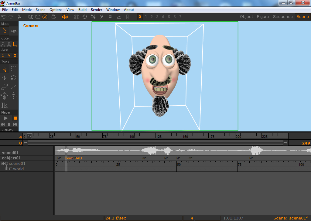

I wanted to test the lipsync tool against  my statement that "Using only the phoneme and graph editor", to create keys, "could produce credible lipsync."
 So here's a  short clip using the phoneme track editor, scrubbing, and graph editor only. No pen and paper,  , and no timetrack editing/tweaking or polishing.
  The speech is fast, which can be difficult to time properly at the best of times, so it's a good test for the lipsync setup in anim8or.
 Remember this is just the placing of keys, and value adjustment with graph editor, and no tweaking/polishing at all.
 (its short and fast, so repeats 3 times)
thecolclough sorry, top teeth should not be moving. Am going to make a new character that will 'stick to the  rules'
 This short clip is mostly a mixture of 'mouth open' and 'mouth closed' phonemes. I think this test shows that lipsyncing fast speech can be accomplished by using no less than the default spacing of 2, for lead and tail keys. and without  overlaping any of the same phoneme keys.
 This is really good news.
 Fast speech is normally the hardest lipsync to get right. (it throws auto-lipsync software/apps into a 'flapping, popping' spin, and the time required to tidy it up, if possible, would have been better spent, imho,  manually laying down the initial phoneme keys in the right place at the beginning.)
The 'Lipsync tool(s)', in Anim8or, are seriously awesome.
 Not sure what other plans you have steve, but I would already give Anim8or a 10 out of 10 for simplicity and capability in creating credible lipsync.
Magic stuff.
 Bye bye Magpie.

johnar Wow! Your 2 mouth-shape speech is really amazing. It will really help for larger groups of minor characters, etc. You won't need to make manyh shapes for each character, etc. I suspect that it would start to break down for slow speech, but it's so much easier that I'd always start with fewer rather than more morphs, then see if it needed improving.
Nice demo.

Thanks steve. yes, all mouth open and mouth closed, except 'F' was used 4 times, ('if', 'give', 'of' and advice and 'S' once, in 'advice'.
Quote
 True. but also, I'm finding that, easily, the most used phonemes are mouth open, mouth closed, F, E, and O, and probably 'S'. ( S = 'E' with teeth)
 I'm pretty confident that those 6 mouth shapes, in conjunction with graph editor, are enough to cover pretty well any speech.
