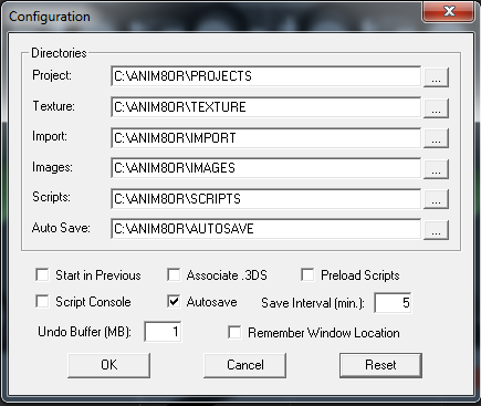

johnar
  • Posts: 1032
  • Make it, Move it--Give it Life
    • youtube vids
Re: What the...?
« Reply #5 on: July 02, 2021, 04:55:03 am »
 File -> Configure
